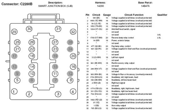

These two connector pinouts show the location of the door, hood and lift gate ajar signal terminals. IIRC each switch is grounded when the switch is closed. You can test this by manually closing the door latch. Also consider the wiring to the door's. They tend to see a lot of flexing and should be considered as well as the switches.
If you want a work around than you could ground the failing switch at the SJB. Effectively the SJB would never see the switch open.
