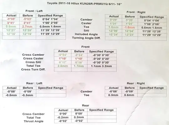

On the other hand, when I previously did all-four wheel alignment for the vehicle, the report showed that camber and toe for the rear wheels was actually changed, even though there was no Specified Range for them:
I am therefore wondering if the rear wheels
  1. were actually aligned. If they were, which bolts/nuts etc. were actually adjusted?
  2. are supposed to be aligned on 2005 Toyota Hilux (KUN26 frame), in particular when the wheels or wheel bearings are changed?
  3. are supposed to be aligned on rear-wheel-drive vehicles at all?

Rear wheels can be put out of alignment by hitting kerbs etc.
Fitting hub bearings, either semi, 3/4, or fully floating types does not affect the alignment, but collapsed bearings will - however other problems are more obvious...
As for adjustment , some of the fixings are designed with eccentric bushes ie the hole is off-centre to allow adjustment, or the bar has an adjustment mechanism built in.
