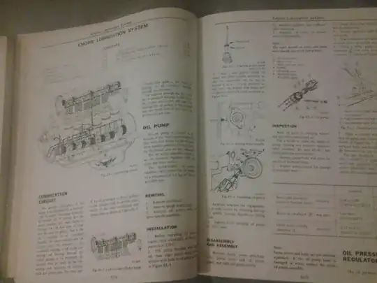

If there are doubts about the aftermarket publishers recycling figures, here is a late 70s Datsun factory service manual:

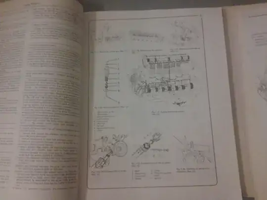

and Haynes..
You can pretty much find every drawing in the Haynes book in the FSM.
Re torque specs Haynes took the liberty of rounding ranges to a single number, eg 93-107 ft-lb in the FSM is 100 in the Haynes book.
I did at a quick look find one significant torque discrepancy (almost a factor of 2). I'd guess that's because Haynes covers a span of near 10 years while the FSM I have is for a specific year. You can see if the specs get changed over the years that's hard for the condensed book to capture. (It could also be a typo of course)
