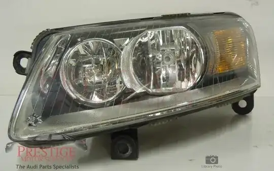

These ones. enter image description here I'd like to buy a pair with an Xenon bulb, possibly with Daytime running lights, however I don't really care about the DRL. Nothing fancy or aftermarket; just the 'standard' xenon-fitted units.

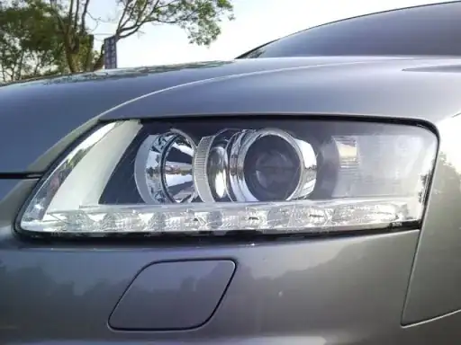

The unit I'm talking about looks like this: enter image description here

If you aren't fussed about adding DRLs to it then you shouldn't have to replace the headlight unit itself, you should be able to just purchase a HID kit and fit them to the existing units.
NB: You don't say whereabouts in the world you are located but there may be local regulations surrounding HID lights - some places require cars with them to have headlight washers and auto-leveling fitted.
