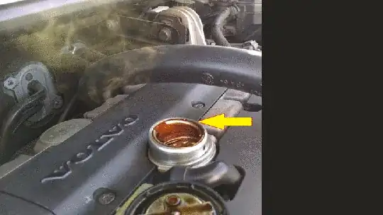

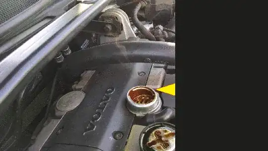

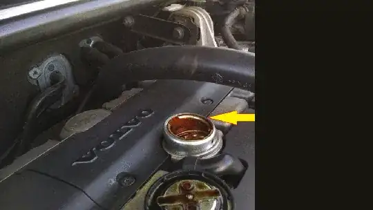

Offering some more background the smoke comes on pretty quick, I don't think I have to drive very far but the images below were well into operating temperature for the engine, smaller trips have a small fraction of the smoke you see in the images below. The still images that comprise the gifs below were generated by holding down the camera shutter button on an Android cell phone going rapid fire mode about 1 a second I believe. The yellow arrow on the right indicates the start of the loop. I was able to image the smoke pretty well with the angle the sun was at.

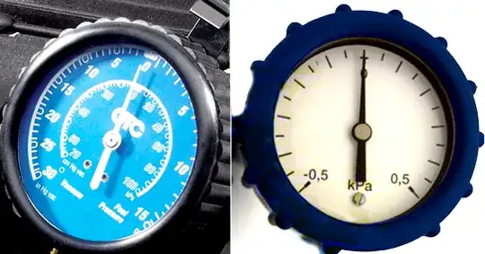

As a comparison to standard vacuum/pressure gauges you'll find OTC 5613 Vacuum/Pressure Gauge Kit which is listed as
Dual scale gauge reads 0-30 in. Hg Vac [0-101.6 kPa] and 0-70 cm Hg also reads 0-15 psi and 0-100 kPa.
One fella even identifies the inability to use a standard vacuum gauge in this diagnosis Volvo Breather Box Tool
I Realized a regular vacuum gauge won't work, you need one that reads in 1/2 lbs and less!
That's because the gauge is reading kPa not bar so a range of -0.5 to 0.5 is very minute. 0.5 kPa only equals about 7/100 psi!
gauge range discrepancy
These gauges are pricey ($150+), but I may be able to find some kind of scientific instrument device that's just as well. I think you can do a homemade water manometer too but I'll have to research vacuum capabilities.

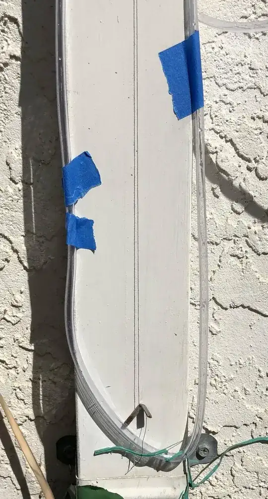

Update 3/11/2018 Crankcase Pressure Measured High According to Water Manometer
I built a small water manometer from some aquarium airline hosing and filled it with an incredibly small amount of water. I had a small syringe for filling ink jet printer cartridges that helped because the volume needed was so very little, probably on the order of 0.5mL or less. Using the hose like a straw invariably overfilled it, hard as I tried to gently do so. I had to inject the small volume of water and then lasso the hose folded in half so the U of the line would allow the water to settle into it. This got the bubbles out which is necessary for a manometer to function. However it was a challenge with my choice of tubing since the water surface tension to the inner wall of the tubing was very strong given the small volume of water and competed greatly gravity which would otherwise allow the water to settle to the bottom. I'd recommend a larger hose if you have one, and adding some dye to the water for contrast. I then set a plumbline with a thread and a random piece of metal for a weight to mark the direction of gravity in the images.
Airline hose water manometer with black thread plumbline dropped in the middle secured against rain gutter downspout
One end of the hose inserted to the dipstick tube and sealed around with putty while the opposite end is left open to the atmosphere. I stuck a piece of blue tape to where the water level came to rest with the engine off and setup a ruler to gauge my measurements from. I then snapped a photo with a tripod setup with the engine OFF, which has the water line high (and even with the other end of the tube's U loop), followed by a second photo with the engine ON where the waterline drops towards the end of the hose connected to the dipstick tube. This height difference is the vacuum the engine is pulling and thus my crankcase pressure. That it pulled towards the engine is sign a vacuum was present but I had to convert the inches of water to the corresponding kPA to ensure I was within the spec spelled out by the Volvo Crankcase Testing section above. The cutoff is 0.2kPa, which if you google search 0.2kpa to in water it will pull in the google converter and give you a value of 0.8 inch of water. With my engine it was approximately, and seemingly just under, 0.5 inch, telling me that my PCV system was likely partially clogged.
Side by side engine off/on water level difference

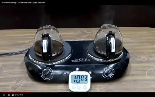

One other piece of information I've come across is that apparently motor oils undergo evaporation naturally when exposed to heat as I just learned watching this episode of Project Farm.
"Nanotechnology" Motor Oil Better? Let’s find out!
You can see all the steam of some kind rising out of the coffee pots he puts the oil into and heated over burners. He actually measures weight loss after 2 hours of heating at just over 410°F of 3.65g and 5.0g between two different brands of oil.
oils being heated on hot plate
So back to my images posted above, there's nothing really unusual about vapor coming out when oil is subjected to heat.
