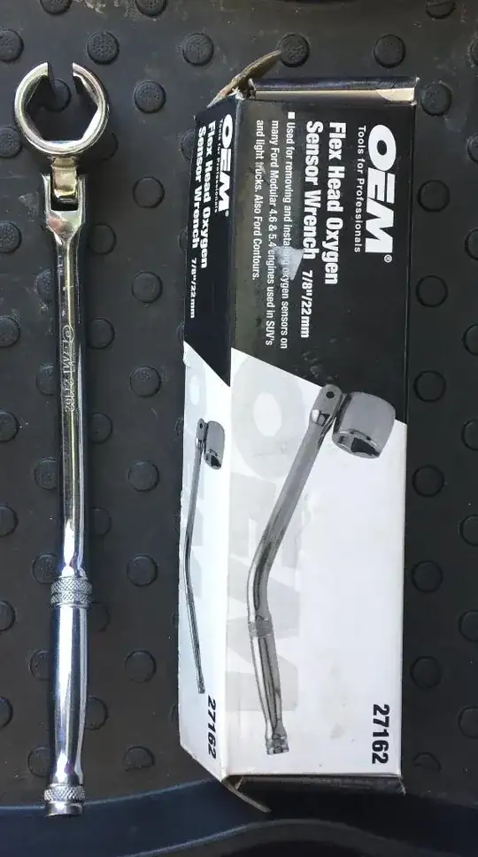

I don't want to hijack the answer from Myself, but I do want to submit a photo. I recently had to work on a stuck Heated Exhaust Gas Oxygen (HEGO) sensor. I had been attempting to use a friends Snap On branded adapter (basically a large socket with a slot in it for the wiring) and I just couldn't get the tool to fit easily. The socket was just too long. I tried using a variety of wrenches and crows foot adapters. Nothing would work. I ended up borrowing one of these from the Autozone free tool loaner program. (Autozone has a program in many places that essentially sell you the tool, then give you a FULL refund if you return it within 60 days...Great program for tools you use once every three years...)
This tool was way awesome. You could easily apply a whole lot of torque on the sensor. It was beefy and well built.
Oxygen Sensor Wrench
