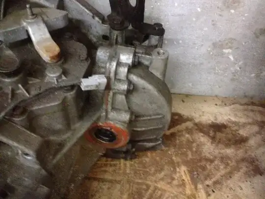

How can I know if there is an LSD installed on a transmission from a Dodge Neon 2003? For what indicators should I look for?.
If you have at least one halfshaft available, you can turn one side. If the other side (might need someone to help you look) goes the same way, it's at least a limited-slip.
