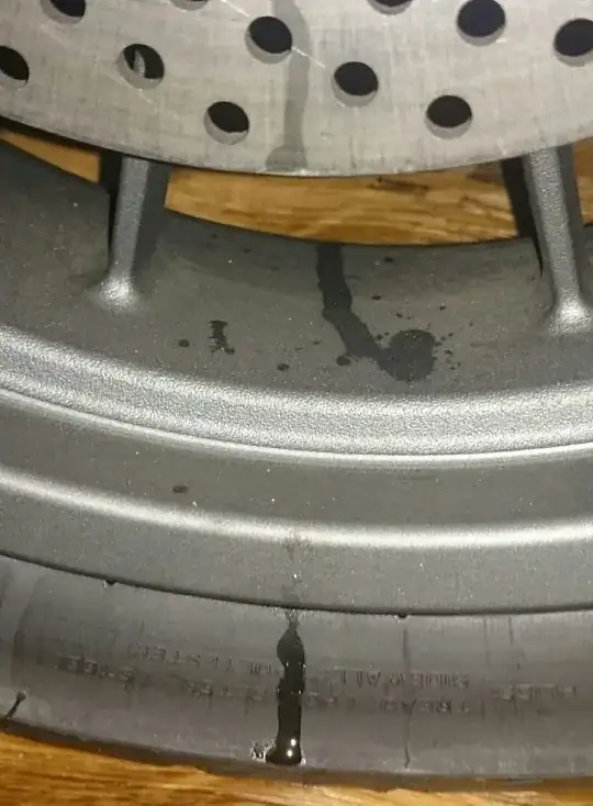

I would check the pistons I had the same issue with rear disc and caliper until it dumped it's oil due to poor oil seals.enter image description here
