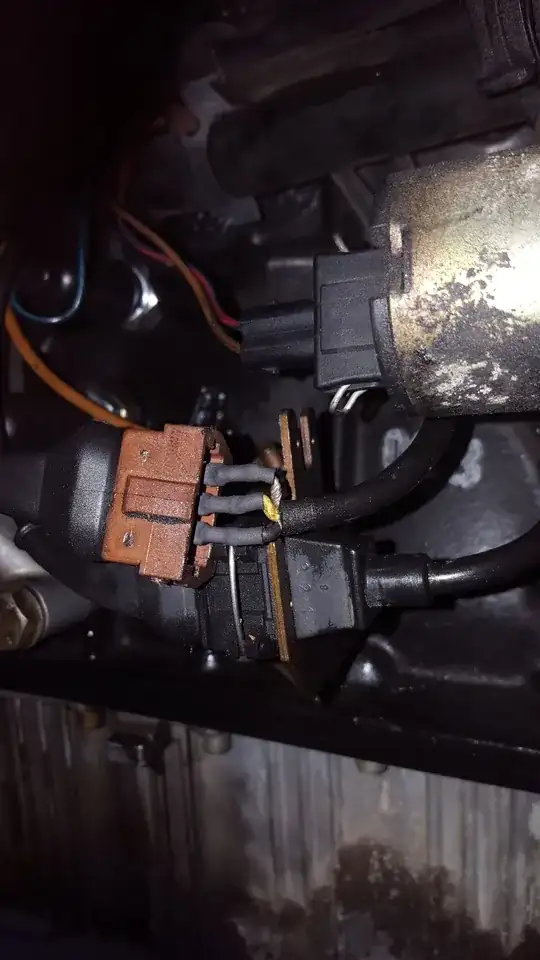

My 1995 5 cylinder Eurovan has the engine light coming on and I don't think the transmission is switching gears properly, it starts out of the gate properly and switches gears a couple of times but around 30 miles an hour it doesn't jump into the next gear. A little history prior to this happening:
One of the oil pressure switches was leaking oil so I decided to replace both of them, in the process I wanted to remove the connection in the picture from the bracket it was in to give me room to the upper pressure switch and the male connection side pretty much disintegrated when I removed the connection. I was able to remove the remnants of the connection housing and insert the 3 wire connectors into the female side and it appears to be pretty solid.
I'm not really sure where these wires go yet and thought I would throw it up the board to see if someone can let me know if this is the culprit of my new problem.

You were right Solar Mike, one side of the harness had a black, yellow and White wire and the other side had a black, yellow and a grounding wire. I at first hooked up the black to black, yellow to yellow and the white to the grounding wire. I went back and reversed the black and white so now the black is connected to the grounding wire and the white is connected to the black wire and it is back working the way it should.
