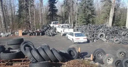

Depending on ozone levels,[id.electric motors $atrunning thunder lightnig ect temperature] these are factors that occur in your environment I live in Alaska have safely sold used tires for twenty six years.we dont have the stunning heat that wears tires quick.i wash stack sort and measure tread depth.i sell tires for 160. A set add for load E,look pro,studded or non mount for fifty.a lot of ignorant people in social media sell tyres not knowing anything about industry standsrds,.I sell well stored tires fifteen years old with no problems.enter image description here
