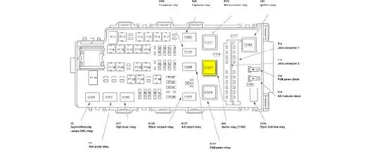

I'll make it very simple for you, Dave.
Just remove the relay highlighted, in yellow, from the diagram above.
This goes to the starter.

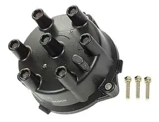

The wire that they disconnect in the movies goes to the coil plug in a distributor cap like this:
Distributor cap with incoming plug
Source: http://www.autohausaz.com/pn/03330
The wires from the outer plugs go to the spark plugs. The central one brings the power in for all of them. So removing the central wire will disable the vehicle.
They also might remove the distributor cap entirely. Or they might unbolt it and remove the rotor from inside so that the spark doesn't travel from the coil wire to the spark plug wires. Any of those involve unbolting the cap, which is more work than I'd want to do in this situation.

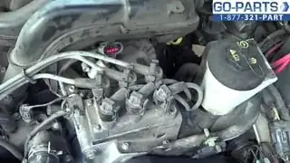

The 2002 Ford Explorer does not have that kind of distributor though. It has an integrated ignition coil instead:
Ignition coil for 2002 Ford Explorer
Source: https://www.youtube.com/watch?v=tYf_0zqS1RA
That video shows how to remove and replace the ignition coil. It's not something that you'd do quickly. It's a non-permanent way to disable a vehicle that you may be able to do without entering the vehicle (if you can release the hood). A simpler method would be to unplug the six wires, but it's easy to put them back in the wrong order. That can cause the engine to run incorrectly. Unplugging some but not all the wires can allow the engine to run just well enough to reach a no parking zone but not well enough to drive. Pretty much the opposite of what you want.
