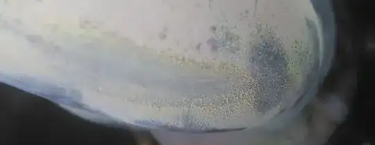

I took off the heat shield from the exhaust manifold on my 2003 Nissan Primera while looking for an exhaust leak, and I noticed this yellowish poweder / dust on it:
Any ideas what it is?

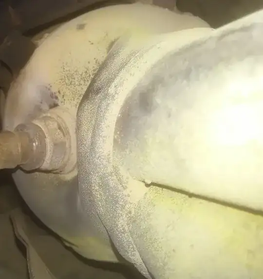

EDIT Sept. 19th 2017
So I wiped a section of the yellow powder with my finger and this was the result:
There seems to be another layer of something under the powder which got wiped away at the same time, and the yellow powder itself seems grainy.
I also verified ( as well as I could ) that there is only one exhaust leak which is from the base of the O2 sensor. I stuck a funnel in a length of hose and had my wife block the exhaust with a rag and this was the only place I heard anything, and the change in sound was quite pronounced when she blocked the exhaust.

IMHO that powder is either:
  • Dust, that got "burned" by the hot exhaust manifold and transformed into some yellow-looking substance.
  • Sulfur, as the color has a striking resemblance to sulfur. The presence of sulfur could indicate a leak and a faulty emission treatment system. There are test strips available to test for sulfur. Should you decide to try a test please get informed about the correct procedure and the risks of this test (lead acetate and Hydrogen sulfide are poisonous)

If your engine was running / exhaust manifold hot; the yellow is then zinc oxide. It would result from a galvanized steel manifold which has naturally oxidized. At room temperature the ZnO is white , I forget the temperature where it turns yellow.

The answer by @Robert is correct.
This yellow powder is Hexavalent Chromium CR(VI), the most toxic form of chromium. It is found on exhaust manifolds as a result of heating stainless steel to 600°C. Do not get it on your skin or inhale it.
Here are additional references:
Regarding the other answers here:
  • Zinc Oxide becomes yellow only when heated. It returns to powder white when cool.
  • Any dust would be burned off on the exhaust
  • Sulfur is also yellow, but would have burned off the exhaust as well
This is not dust, ZnO or S. The yellow powder is Cr-6.
