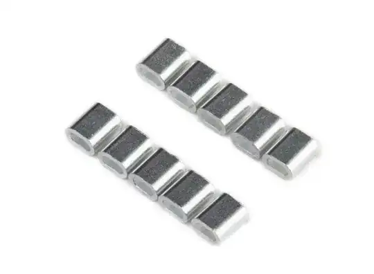

    • Crimping Tubes (Aluminum) Found them at a rc hobby supply store - but they are not intended for (stranded)wire use at all Crimping Tubes

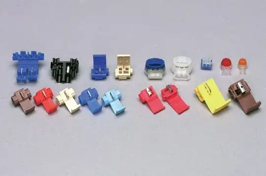

    • "Scotchlock" Type
      They are intended for automotive use; however i don`t consider this a permanent or even sufficient electrical connection. enter image description here

I have repaired many wiring harnesses with soldered joints (made the joints very slim so that the repair looked as per original once taped up - no bulges etc) both in the engine bay and under the dash.
Soldered joints do not have any problems and, done properly, will have a lifetime longer than the vehicle. However, if you let moisture get in there then you will have corrosion issues, but you can get corrosion issues from wet wiring anyway.
I would seriously suggest that you avoid all those "crimp" tzpe connectors shown in the images - they will all let in the moisture...
