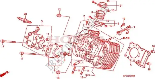

The Carb Insulator Rubbers connect the carb to the Head inlet.
(top of image) no.8 = Carb Insulator Rubbers no.9, 21 = Insulator Bands
To fit them on, I would need to cut two protruding knobs off the Insulator Rubbers, which are only there to stop the OEM clip from sliding around, making access to the bolt difficult.

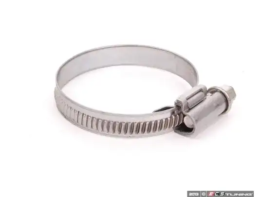

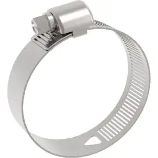

Jubilee Clip
A Standard Jubilee Clip/Hose Clamp (Image)

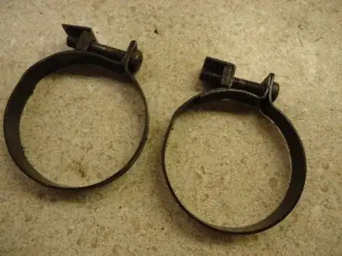

OEM Clip
OEM Carb Insulator Clips (Image)

I don't know why it wouldn't be safe. Each performs the exact same function: to prevent leakage between the outer soft part and the inner hard part (whatever might leak through) ... (yah, that's a lot of words to just say "form a seal").
The main reason the OEM clips are used is they are cheaper to produce en mass. Even if you save $.02 per clamp by using the OEM ones over the jubilee, when you're talking a few hundred thousand clamps, you're talking thousands and thousands in savings to the manufacturer.
If you have any doubt why cars like Mercedes are more expensive, it's because they use things like superior hose clamps. Below is an example of a genuine OEM Mercedes-Benz hose clamp (or jubilee, if you prefer):
Go to pick apart yards which handles MB vehicles and get yourself some for cheap.

  • 259
  • 508
They'll likely be fine, however just double check that everything is sealing properly, as quite often many of those OEM bands are slightly narrower compared to jubilee clips, and so they sit in the carbs insulator sleeves perfectly thus creating a proper seal.
