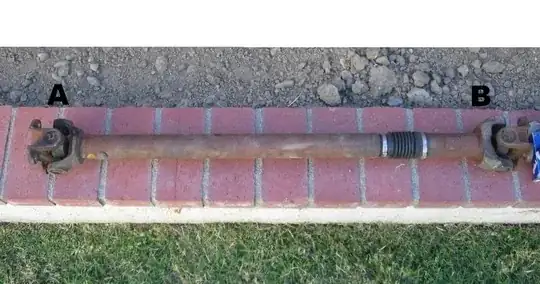

  1. The drive shafts should be clocked the same to each other on a drive shaft. In the following picture you can see the yoke on both ends are right in line with each other. If you don't orient them this way, you're going to get vibrations and the u-joints will wear out fast. enter image description here

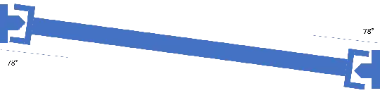

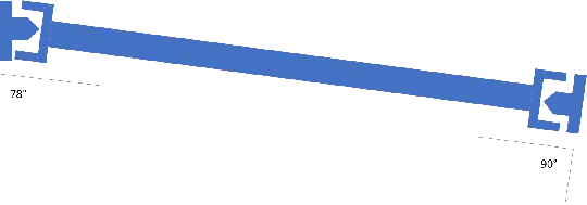

  2. Each end should have complimentary angles to each other. If they are not complimentary, again vibrations and wear occurs to the joints. These have to be pretty close to not incur these issues.
Complementary angles (GOOD):
Non-complementary angles (BAD):

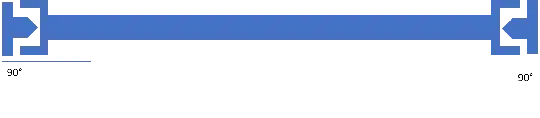

  1. The yokes should not be exactly perpendicular to the drive shaft when attached to the diff/tranny. The reason for this is you need the u-joints to move a little bit so the grease is moved around inside the bearing caps. If they are straight, portions of the bearings will dry out causing them to wear out. You don't need a lot of angle, just a bit ... probably 2°+ will do you. Just something to keep the needle bearings moving all the time.
Perpendicular:
