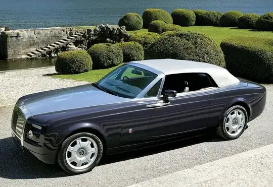

Another interesting point of not is how this fender/door distance is also increased with older cars and cars that just had huge motors and were RWD. This creates a huge distance between the front wheel well and the door because of how long the engine is. Rolls-Royce 100EXenter image description here
