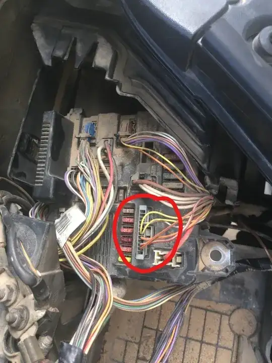

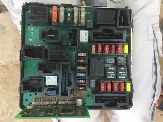

My car is a Renault Scenic II 1.9 dci (Diesel) ... the car was working fine and everything was good except one small problem (it was small) ... the problem was the left headlight (rear one) stopped working. So i took it to a friend and wanted to change & check that lamp ... we discovered the "lamp" itself was working fine but we suspected something (error & prob) in the fuse-box. We checked all fuses, they were all fine & only one relay in the fuse board seemed to be slightly disconnected (underneath).
NOTE: Of course this needs to disconnect the battery first and disconnecting all the wire cables of fuse-box.
So we welded that one and rechecked all the fuse-box board diagram and relays & fuses (with voltmeter)... everything was fine...Then we reconnected the fuse-box cables and the battery... (up to here everything seams typical)... we checked the headlight (left one) it becomes OK and worked fine.

  2. Cleaned the fuse-box & cables & slots with a special spray for (for electronic boards)

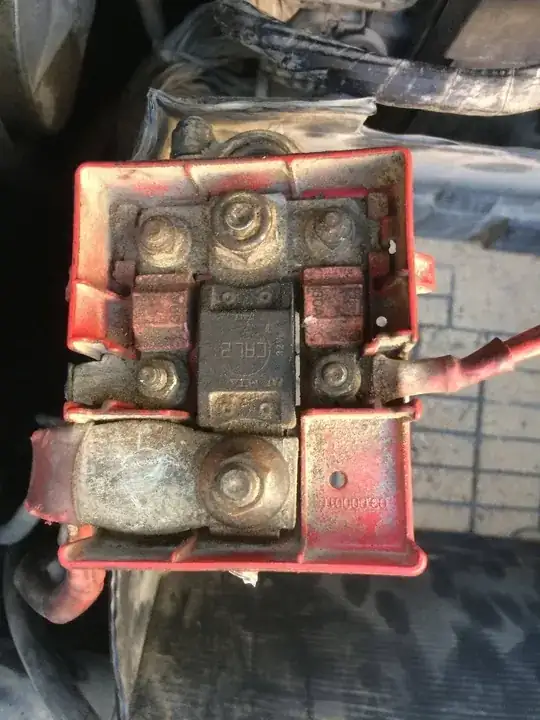

  2. battery cables (positive) & fuses (it has three fuses) they are working fine but needs to be cleaned... they seem to be corroded... I don't know if this makes any different!!!

I would like to inform you that the issue has been solved....the problem was caused by the wires in the grey plug (plz see attached picture) which responsible for feeding the electronic board with electric & power... we this plug has been resolved... then, the error message "steering locked & Not locked" disappeared & the car start just normal now... thanks anyway for giving me a chance to share my experience with you.
Regardsenter image description here
