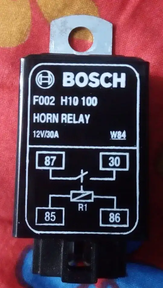

I want to install fog lamp on my Maruti Suzuki alto 2009 model, but it did not came with any provisions for such modifications so I have to do it from scratch, the problem I am facing is that I cannot find any relay from authentic manufacturer, all the relays in my local shop are cheap and not from any reputed brands and costs around 50-100rs (around 1-2$), but in one shop I have found a genuine Bosch relay for around 200rs (around 4$), the problem is that this relay says it is an horn relay, after researching in internet and also in local car mechanic shop about differences between horn relay and light relay some says that as horns are not meant for longer use they might wear out prematurely if used with fog lamps. So my question is should I buy this bosch horn relay and put it with fog lamps and not worry about it or should I get try to find proper relays. Also please inform if any other informations are required
Lamps are 2X35W. added image of the relay

If you provide the Bosch number, I could look it up. In general, my experience with Bosch relays is that they tend to not have interim duty relays.

Addendum #1 You included a photo of the proposed relay. The literature I have on that relay is limited, as it appears to be marketed in India and other locations, not in the US. It also appears to have limited application to horns, and I would therefore assume that the relay coil is not designed for 100% duty cycle. You might look for a different part.

You could just control them directly with a rocker switch rated at 10Amp (or higher) and fused accordingly (7.5A - 10A). However, if you want to use a relay for the sake of keeping things clean and organized, then the horn relay you show will more than meet your needs.
A horn relay has no extra special magic in it that couldn't be found in any other relay that is rated for the same specs...12V/30A. It just happens to have a nice little Horn label on it so we can assume it will have a low current coil. The coil of the relay ( the part you attach the switch to #85-#86) is going to be rated for a low current like 12V/150mA max. This way you can have a small switch with small gauge wires, control a huge amount of current if needed.
