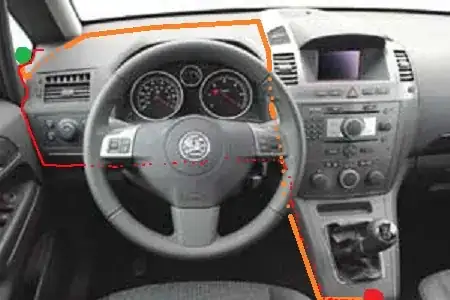

I have a GPS device (or a cell phone cradle) in the corner of the windshield. I need to run a USB cable there to provide power to the device. I have a simple USB power plug for the lighter socket, and a black USB cable that is long enough to cover the distance while following the bends and curves of the dashboard -- so it's not a clothesline strung straight through the car. It can be neat and tidy along some ridges and edges, if I find a way to do it. How do I affix the cable to the dashboard in a reasonably simple yet elegant way?
Here's where I plan to have the cable (orange) from the charger (red) to the device (green). There are some seams here where plastic parts meet. I can't stuff the cable into the seam but perhaps I could stick some kind of clip into the seam to hold the cable in place along the outside of this seam?
I guess I could hot-glue the cable in place, but that would be hideous and also hard to remove. I asked my local car shop if they had some black cable clips or something self-adhesive, but they don't. They could only offer me some black masking tape to use. The shop told me that enthusiasts (who put all kinds of electricals everywhere in their cars) can disassemble the dashboard and run the cables internally. But I'm just a regular guy that doesn't want to dismantle my car :-) I don't want to end up with something like this.
I would take a different route.
  1. Starting at your end point (the green dot) put the connector on the dash where you want it.
  2. Run the cable next to the front vent glass. Push the cable down the crack between the glass and the dash.
  3. Open the door. There is usually room to run small cable down the left side. Sometimes you can tuck a single cable under the weather striping.
  4. Look for a seam in the trim to make a transition under the dash.
  5. Run the cable under dash along any existing harness to the center console.
  6. At the center console run the cable down the back.
  7. Once you reach the floor take the route you have already diagrammed. The plastic housing around the gear select will usually have some give and press into the carpet. Just push the cable under the housing.
Once the cable is ran use zip ties to secure it in place. There are some zip ties with sticky pads on them that you can use behind the A/C control area. You shouldn't have to remove anything major. Making the transition from the door jam to under the dash will be the only tricky part.
Just keep in mind that you do not want to run the cable in the way of anything that moves.
Good luck!

I use packing tape (clear, strong tape from e.g. the post office) and epic twist ties to rig up stuff like this. I hook the twist ties into the heating vents. The twist ties are especially useful because you can just untwist them if you want to release the cable for some reason.
