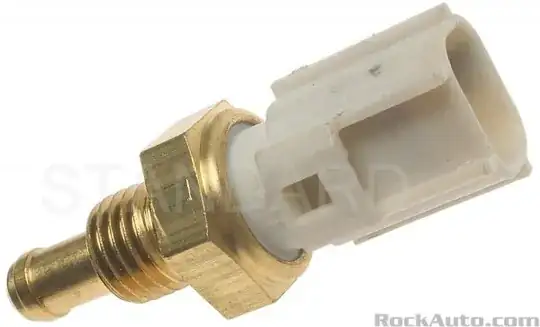

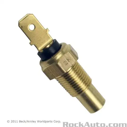

For your 626, I'm seeing two different temp sensors listed. I'm seeing this single bladed one:
Which shows to be associated with the gauge. I also see this two bladed one:
Which I assume is for the ECU. I'm going to give an educated guess and state your Mazda is setup with the separate sensors which works out well in this case.
As for other cars, this is not an uncommon setup. I've seen a lot of different models setup either way. It all depends on how the manufacturer has them setup. I'd suggest it is going to be rarer in newer vehicles. This is because in a lot of them, the ECU runs the dash ... it collects the data from the different components and displays those readouts on the dash. In those cases, you'd only see one temperature sending unit and what you'd see on the ECU if plugged into it gather live data and what is displayed on the dash to be quite similar.
