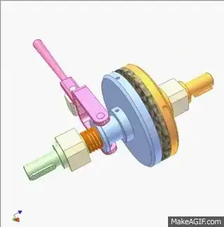

I agree. Most likely you were riding the clutch. It'll smell gross, not like a typical burning smell. It's common with hillstarts because people tend to stress about either dropping the clutch too suddenly (and stalling), and/or rolling backwards.
Basically, when you release the clutch pedal - the clutch plate and the pressure plate become interlocked. To put it simply; it connects the gearbox (and by extension, the wheels) to the motor, causing the wheels to turn (i.e. drive/rotate).
Clutch GIF
←Gearbox | Engine→
The clutch pedal is an extension of the pink fork/lever.
It connects/disconnects the blue pressure plate to/from the gold clutch plate.
So, when you don't release the clutch pedal quick enough - the clutch plate and the pressure plate won't fully engage quick enough; they'll just rub up against each other and generate heat, until the pedal is released enough for them to interlock.
It's like what happens to the tyres when someone does a burnout. The tyres are spinning really fast against the ground, unable to gain enough traction, but generating a lot of friction instead (and thus heat), causing the rubber to burn, smell, and produce smoke.
