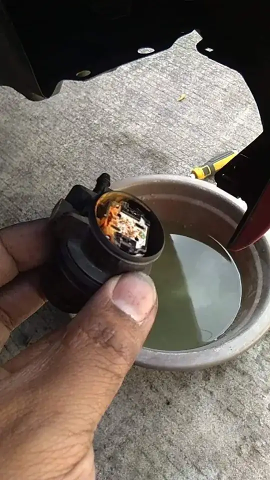

I have also a faulty front washer yaris 2013... But better check first before you buy a replacement..mine stop woking because of rusty connectors because water leakage.. I try clean it with wd40... brushed it then test it now its working.. I believe pump motor is sealed so 95% its still goodenter image description here
