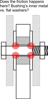

I'm specifically trying to understand "where" the friction happens when swing arms or wishbones moves up/down. In an ordinary assembling, the securing bolt goes through a few stuff like chassis or wishbone, then some flat washers, then through the bush's inner steel little "tube", etc. And then the bolt gets well tightened. So when the assembling moves up/down, the bolt remains in its position, i.e, it won't swing together with the assembling. However, which part takes the friction, if everything is tightened? Does the rubber twists? Or the job is taken by the flat washers against the chassis/wishbone/bolt head/etc and the inner steel tube? If the bushing just swing around the bolt why it doesn't need some kind of bearing? Isn't the bolt vs. inner tube steel a metal vs. metal "grinding"?

In a wishbone, the rubber bushing acts as both a spacer(inner metal) and a damper(outer rubber). So when you bolt it all up, the bolt tightens across the spacer and it gets locked tightly. Now when in use the overall suspension rotates over the bolt and the friction happens between the inner metal spacer and the plane surface of the bolt. However, the range of motion is so small that the rate of wear on these parts are minimal and can survive very long distances however they are not eternal and are replaced by your mechanic after regular intervals.
Coming to the swing arm, this is designed for similar purpose and since it is a critical part and tedious to replace regularly, the bolt itself is made with a few greasing holes. Even here, the bolt rotates inside the inner metal of the spacer and there is a tiny gap between the two surfaces where grease is applied by pumping it into this space. Basically there is lubrication between these two parts and the friction is marginally reduced therby preventing 'grinding'.

The rubber is bonded to both the inner metal tube and the outer metal housing. The inner metal tube is bolted tightly to the moving arm, and the outer metal housing is bolted tightly to the chassis.
The movement comes from the rubber flexing. There is no 'friction' so to speak (unless you count the molecules of rubber in the bush pushing/pulling each other).
It's a bit like holding your wrist with your other hand, and then twisting your wrist slightly. The flex comes from the movement of your flesh (the rubber bush).
