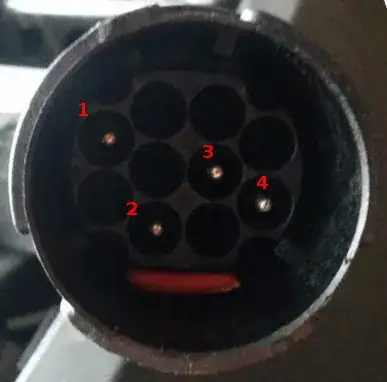

This question might be too technical for this forum, but I'll give it a go. I have a 2012 BMW R1200R motorcycle with CAN-BUS. I'd like to make an Arduino interface to the connector on the bike, but I don't know the pin definitions...
Do anyone know the pin definitions or how to figure out what they are?

Pin #.Wire color.Ohms with disconnected battery.Voltage with key off.Voltage with key on
1     Green/Blue  3.2 ohms                       0 V                   12.25 V
2     Red         2.2 KOhms                      12.9 V                12.32 V
3     Brown       0.4 Ohms                       0 V                   0 V
4     Brown/Black 16 Ohms to 12.4 Ohms           ~0.003 V              11.2 V
Pin 2: Two +12V lines probably means this is a battery pin?
Pin 3: Possible ground pin with two 0 volt pins?
Update 2:
The OBD Wiki shows that for these pins it must be one of three protocols: ISO 9141-2, ISO 14230 or ISO 15765. I don't have all the chips needed to test 9141 or 14230, but I'll have them and another update within two weeks.

I was looking for the similar thing and stumbled on a page which describes the protocol for the 650gs. I haven't managed to try it out yet but it seems promising. http://www.f650gs.crossroadz.com.au/Diagnostics.html
Topic is discussed here as well: http://f650.com/forum/showthread.php?25550-Diagnostic-plug-pinout-does-anyone-have-it
Plese let my know how are you doing with your project. I have a similar arduino-gs-related thing in mind :)
