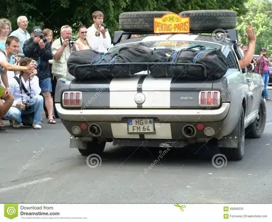

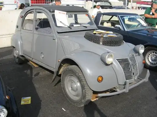

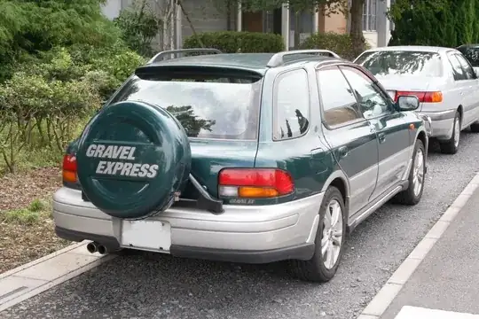

Short of chopping and welding the boot floor, you could possibly create an artificial boot floor that sits higher than the existing one.
Some outside the box alternatives are;
Spare on Rear
Spare on Bonnet
Spare on Roof
