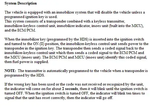

My 2006 Honda Civic does not start in the morning. It is showing a green key sign on the dash board, which makes to suspect the key immobiliser. It will start in the afternoon when sun has hit it well. The battery and the starter are good. I live in warm climate, so it is not cold. What could the cause be?

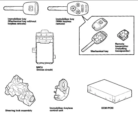

Here is some data about your immobilizer system, hope it helps. Not sure if there is a battery in the key or not, if it does have a battery it may be dead and need replaced.
