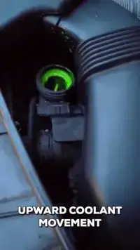

UPDATE#1: I tried to do the test according to the instruction. However, I think I actually contaminated the test fluid because after thermostat opened there was quite strong upward movement of coolant. The coolant level was so low that "low coolant" light was on in the dashboard. Now I am wondering if such upward movement of coolant is expected for BMW X3 or if it is sure indication of a blown head gasket? If it is expected then would this car be rather tested with two-level tester where coolant would be less likely to enter the second stage?

If the system you are working on has a sealed radiator, with an expansion tank instead of a surge tank, with the only working pressure cap on the expansion tank, then yes, insert the tester in that opening instead.
The way these testers work is they test for hydrocarbons in the coolant system. If the engine is sealed correctly, there WILL NOT BE hydrocarbons in there. Any indication of them (where the testing fluid turns from blue to green or even yellow), it means one or more cylinders is leaking into the cooling system and there is an issue. If you have an expansion tank, hydrocarbons in the cooling system will wind up here as well, so testing there will be as conclusive as if you were actually testing off of the radiator itself.
Yes, run the car without the radiator cap on. You need to get it up to temperature before using the tester. Since you don't want to open a hot radiator, it only makes sense to have the cap off. Just keep an eye on it and make sure it doesn't overflow.
Just as a note, the thermostat won't keep combustion gases from entering the cooling system, it just won't circulate the gases forward to the radiator, but rather just run them around inside the engine instead. I know this is semantics, but I just wanted to clarify the point.
One of the instructions wants you to ensure there tester is completely free of coolant. You should be testing the fumes coming off of the expansion tank/radiator, not the coolant itself. This will foul your testing, so keep the tester dry of anything but the testing fluid itself.
