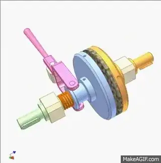

Look at the following animation
Clutch Engaging
The yellow part comes from the engine and it's always rotating. The blue part goes to the wheels.
In simple terms, when you press the clutch pedal you remove the link from the engine to the wheels. When you let the clutch pedal, you link the engine with the wheels and (if you are in gear) the car will move accordingly.
For the second part, imagine you push an empty shopping cart. It's easy, and you will push it with some speed (eg. engine RPM).
At some point someone drops a boulder in the cart (eg. engaging the clutch). In that moment your speed will drop (eg. RPM drop), and for you to walk again with that speed, you will have to put more effort (eg. accelerating an engine).
I hope that answers your question
