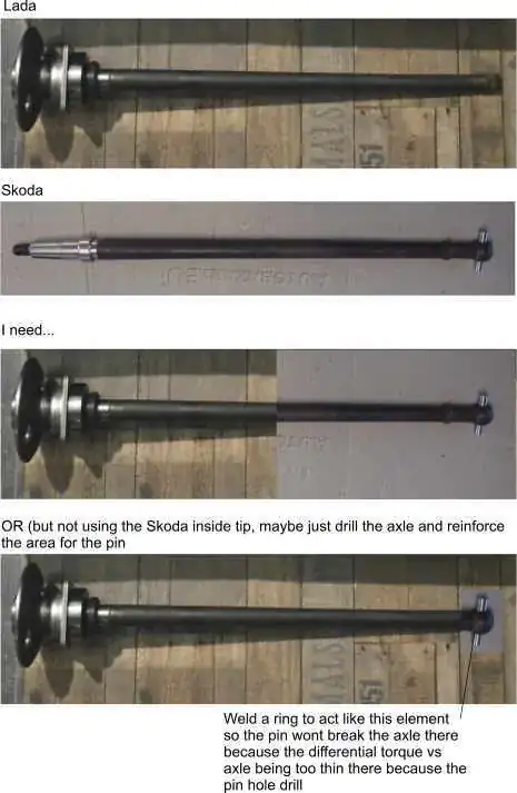

The car I'm rebuilding (Skoda Estelle/120, 70's, RWD, rear-mounted engine), uses half axles for the transmission, that goes inside housing elements (thick "pipes"). These axles uses pin-and-guiding blocks as link to the differential (housed together with the gear box), and a woodruf key in the conical-profile tip where the wheel hub gets secured. The main problem I always have with this design is that the woodruf key/hub/nut assembly gets loose very often, so I want to try a different design.
The half axles I can have are from Ladas. The design is different: the Lada axle is a typical front-mounted engine with rear transmission. However the bearing is the same and its size gives me room for adaptations.

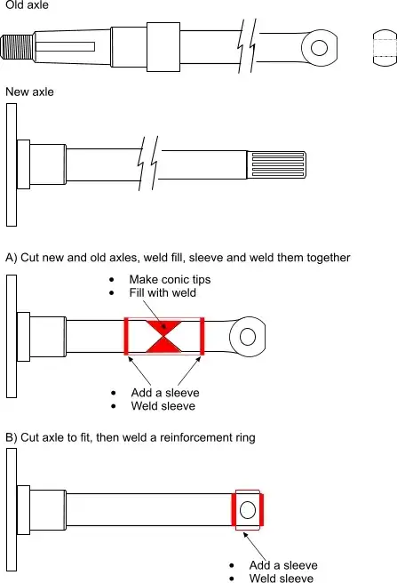

In the inside tip, Lada's has splines, Skoda has pin-and-guide block. I'm aware about precision that this needs, I know it needs to be done in a lathe, welding by hand turning the aligned parts, etc.
I can
  • cut both axles and weld together the appropriate sides, reinforcing the joint by welding a sleeve, or
  • cut the Lada axle and add a reinforcement ring at the pin side (probably an inner track of an old roller bearing).
The main issue: the diameter in the Lada axle, where the pin hole would be drilled is less than 30 mm; the Skoda's diameter there is 32 mm. So somehow I need to add body or reinforce that tip.
My question is: how should I work the inside tip?
When answering, please keep in mind I don't have access to much more than what I describe.
Engine is 1200cc...See the diagrams I made to support the question:
EDIT: added more pics of what I'm after :)

I can only suggest this as I've not done it myself nor have I seen it done. I do, however, know your situation, so I believe this is your best bet (considering).
My suggestion to you is to go the sleeved route. The only problem with it will be it should be heat treated after welding is done. The weld will mess with the hardening which is done to the axle when it is manufactured. Know a little bit (but not a lot) about how metal behaves, you'll never get the end strong enough to survive the torque put to the axle if you tried to drill and reenforce. It just wouldn't hold to my line of thinking.
The hardest part about going the sleeved route is centering the two axles. If they are out of alignment even a little bit, you'll get a wobble which will run a vibration through the vehicle when you get it up to speed. You can possibly friction fit a sleeve on there by heating the sleeve and getting it onto the axle fairly quickly. You wouldn't be able to weld the center of the axle together if you do this though.
It looks as though at least the Lada axle side is tapered. This should make things a little easier in the long run. To prepare the sleeve, you want to have some holes drilled into it. You will be plug welding the holes to the axle to create greater grip on the axle. I would cross drill twice (four holes) in each end. Maybe even offset the holes some, maybe 1/2" difference from the end of the sleeve. Ensure the holes are big enough for the plug welds to get some traction. You will want to weld the ends (around the exterior on the end) on each side on the axles. Make sure your tube is at least 1/4" thick, a bit thicker if you can find it. If the one end is tapered, you could possibly put the tube over the tapered end, sliding it toward the narrow side, then weld the two ends together, sliding the tube over the welded portion, then plug weld the holes, then the ends. Heat treat if possible.
This obviously isn't going to be as strong as a solid shaft, but like I said, I understand the limitations of what you have to work with. I really feel this is your best bet considering. You won't get the strength by just welding the two ends together by themselves, nor with putting drilling the end with pin, even with reinforcing it. Would not take much to break it loose.
