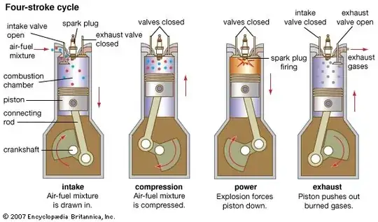

Put simply, an engine's compression ratio is the ratio between the volume of a cylinder with the piston at the down position (position 1 and 4 in the pic below) and the volume of the same cylinder with the piston in the up position (position 2 and 3 in the pic below). enter image description here
So, basically, the volume of the cylinder with the piston in the down position is the volume of fuel and air that the cylinder can ingest (on the intake stroke).
Then, this mixture gets squeezed to a much smaller volume (during the compression stroke) before ignition, and that volume is the cylinder volume with the piston in the up position.
The ratio of the 2 is how much the fuel-air mix is getting compressed. 9 to 10 fold is typical.
