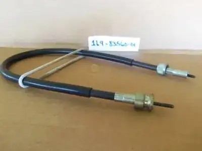

1978 XS400 Tachometer, Speedometer
Part number is: 1L9-83560-01-00
