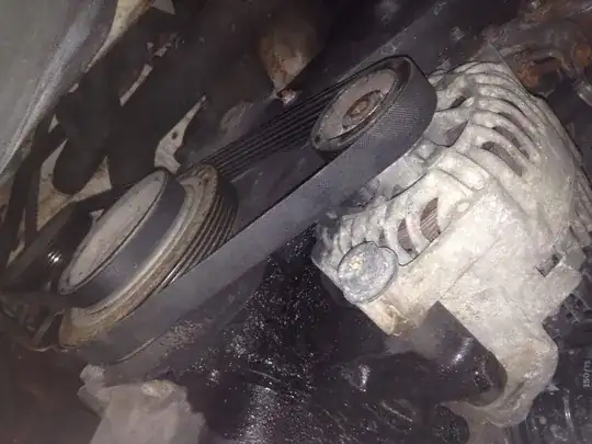

I need to change the belt (closest one in picture) as it's become very loose. There doesn't seem to be a tensioner pulley, so do I just remove the bolt in the center pulley in order to remove the belts? Or is the far pulley in the picture a tensioner?
Thanks
Looking at the large bolt holding the alternator (closest in the picture), then I assume the alternator will pivot on that if you release the smaller bolt on the other side of the alternator - just visible with a piece of metal that has a slot in it. That looks to be how you adjust the tension of the belt.
