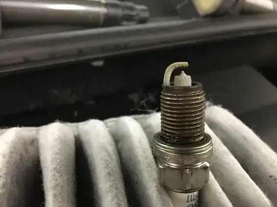

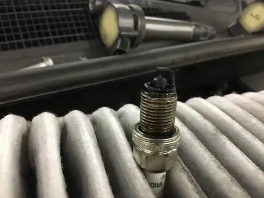

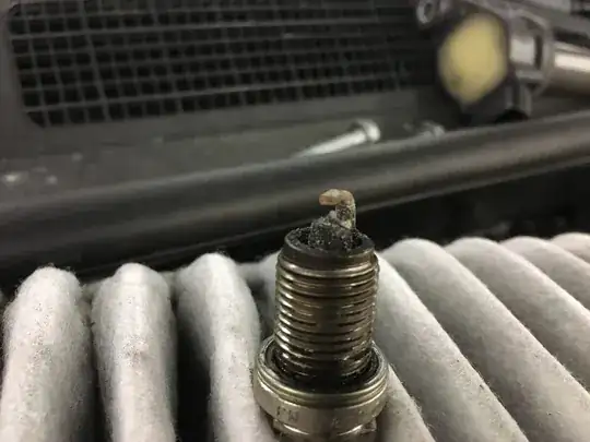

Spark plugs 2, 4, 6 (not exactly sure on the order):
At this point I have purchased a used engine, which is sitting in will call at the scrap yard. I have about 25 more days to decide what to do or they will charge me 20% restocking fee.
