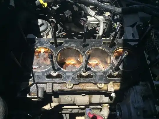

The obvious answer here is a blown head gasket. So, I proceeded to tear the thing down, and found:
The head gasket looks fine. (Note that this is an MLS gasket.) No cracks in the cylinder walls or the head.

I'm taking the head over to the local machine shop to be inspected, pressure tested & potentially resurfaced. I'd rather have them check it out and find that it's fine than put the car back together and learn that it is not fine.
The only weird thing I found is that the RH head stud (ARP) between the number 1 and number 2 cylinders was loose. But, those aren't really supposed to be super-tight, anyway. After the compression test, though, I could see coolant seeping into the number 2 cylinder when looking down through the spark plug hole.

What looks and acts like a blown head gasket, resulting in coolant in the cylinder, when the head gasket is fine?

To answer the question - moot at this point for you I'm sure, but this is a Question and Answer site after all - What looks and acts like a blown head gasket, resulting in coolant in the cylinder, when the head gasket is fine:
  • cracked head
  • warped head
  • improperly torqued ore loose head bolts (torque them down in a pattern)
  • missing parts (o-rings, dowel pins, etc) after engine reassembly.
  • Old gasket material not fully removed
  • the head gasket really is blown you just can't see it
