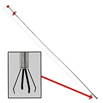

One thing: here's a great addition to your mechanics tool box. These come in way handy for a whole bunch of tasks. The even make em with a tiny led bulb at the grabber end.
grabber tool
You squeeze the top knob to extend and open up the jaws of the grabber. When you let go the jaws retract and grab stuff securely.
