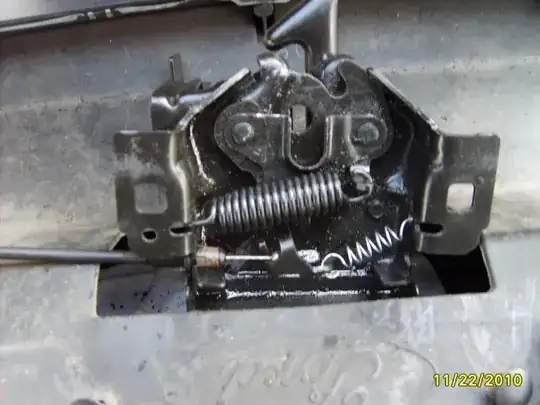

I would guess that there is an issue with the spring on your latch.
Most hood latches follow the same basic design. As you push the hood closed, a bar on the hood pushes into a hook in the latch, and rotates the hook in such a way that the bar is retained by it. As this happens, a spring is tensioned until finally the mechanism becomes locked in place. A cable runs from the latch to your interior where you can pull a lever to open the hood. When you do this, the lock is released and spring rotates the hook back to where it's grip on the bar and the hood is released. The rotation also pops the hood up an inch or two so you can reach under it to release the secondary hook.
There are two springs on the latch. There is likely a smaller spring that pulls on the cable, returning it to resting position once you've released the lever inside the car. The one you're looking for would be a larger spring. If it were damaged or missing, the lock would be released, but there would be nothing forcing the hook to rotate back to it's starting position and prop the hood up enough for you to reach under it. Once you release the lever inside the car, the mechanism would likely lock again, as it remained in the fully closed position.
My money is on that spring.

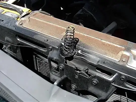

It sounds like there's a problem with the spring that pushes the hood up once the latch is released. On my XC90 it's on the inside of the hood, behind the grille somewhere. It may be mounted to the firewall instead:
http://www.feartheelcamino.com/Images/ReBirth/More%20Mods%20To%20Relocated%20Hood%20Spring%20On%20Radiator%20Support.JPG
Open the hood and look for that spring. My guess is it's either been squished down over time (in which case just pull it open to expand it a bit), bent and not springing any more, or missing completely.
In the event I'm crazy and there is no spring or wasn't ever one, take a look at this thread. There's a bunch of people with your car discussing your exact problem.
http://forums.swedespeed.com/showthread.php?166738-1998-V70-R-Hood-Wont-open
