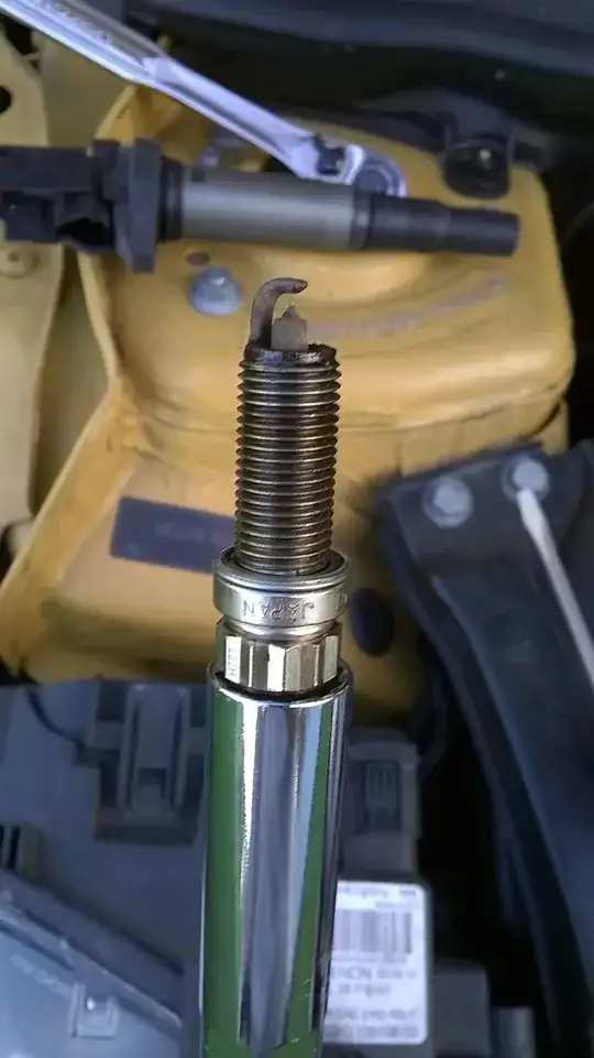

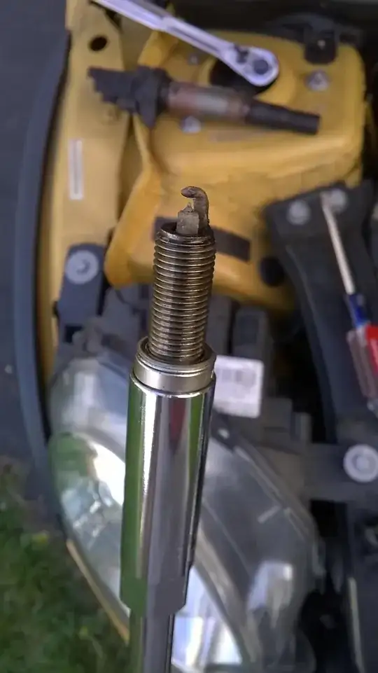

Plugs are replaced. They were not the Bosch's used by BMW, so they had been replaced at some point in the past. Assuming the previous owner(s) folllowed the maintenance schedule, that would have been at 30k miles. I replaced them with the OEM plugs and took it for a test drive. Much better response and much better power.
My cold engine problem remains, however it's not nearly as pronounced. I am getting more convinced that it's a misfire. The coils were very rusty on the outside. My thought now is that they aren't making full contact and thus not always firing. Once the engine warms up, everything expands and they get better contact. Does that sound feasible? I tried cleaning off the rust with some steel wool but I couldn't get it all off and I didn't want to remove too much material. Time for new coils?

EDIT 3: Okay, socket arrived from Amazon. Here are my plugs. Looks like normal wear and time to replace! Plug 1 Plug 2 Plug 3 Plug 4

Start with plugs and wires. Especially if they've never been replaced, they are almost certainly causing your current problems. You can test the wires with a multimeter and visual inspection of the spark plugs can tell you a lot(you can give that a google, or we have a question here about what plugs are supposed to look like).
