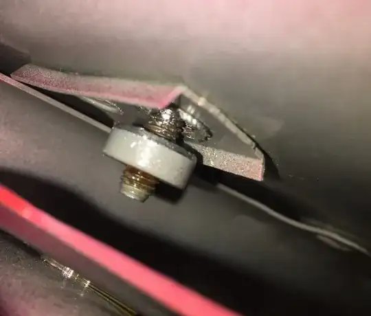

After advice posted to the comments of this question, I ended up looking at the backside of the bolts to size up the situation by pulling off the hatch paneling (how-to: https://www.youtube.com/watch?v=n3EJpG59rhw) and found this: Back of the license plate bolts

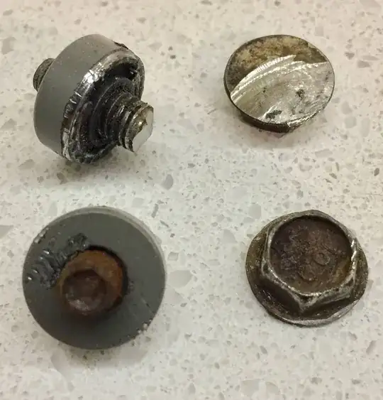

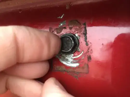

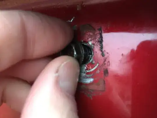

I tried to hold the "nut" with a pliers while turning the bolt but was unsuccessful. Instead, I used a Dremel tool and a cutting wheel to completely remove the bolt from the front:
Bolts and "nuts" after cutting them off

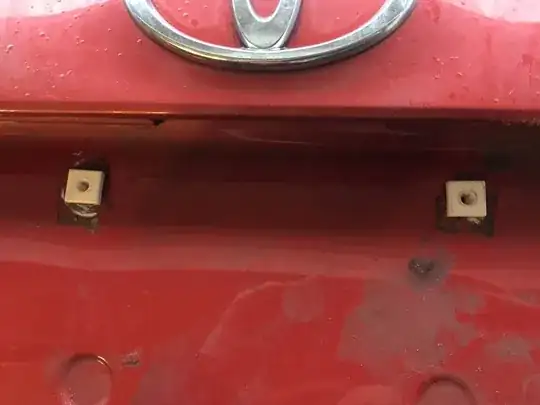

I had to slightly increase the existing hole diameter to fit the replacement mounts, but they fit snug and I'm not too concerned with them falling out anytime soon:
Replacement mounts
