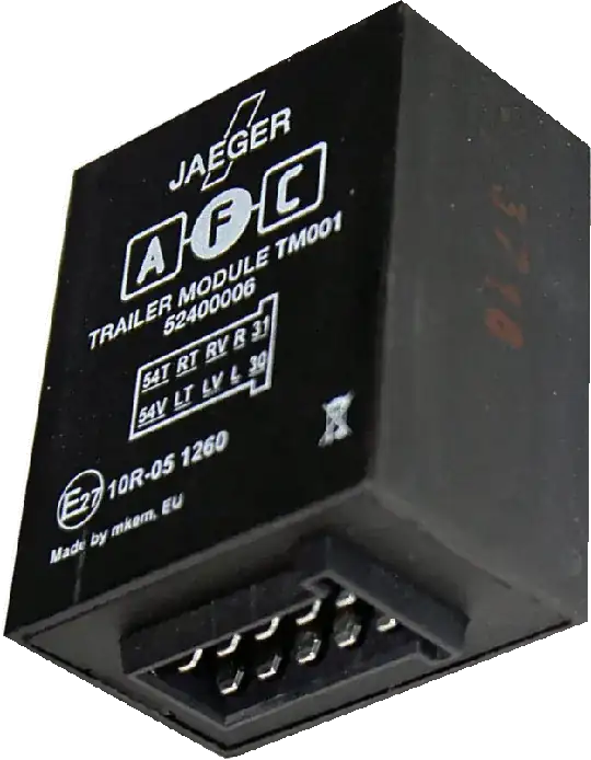

I have a Nissan Murano 2009 (made in Japan for US market). I installed a trailer towing hitch and now I want to install a towing harness. Since I live in Europe I bought Brink Wiring Kit (732614) which is specific for Nissan Murano. This kit comes with a Jaeger AFC trailer module (52400006) which basically is used for wiring the car and the trailer together to power and synchronize their lighting systems.
BACKGROUND
The AFC module (aka trailer converter) has 10-pins like in the image below. It would be helpful to note here that the converter's terminals are supposed to have the following meanings:

(*) by looking at the harness' connectors and respectively at the converter's connector it looks the R and the L terminals provide somehow the same function as the RV respectively LV. However, what's important is that they are also related to the turn signals.

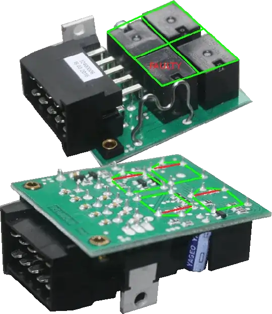

Ok, so as @solar-mike suggested it looks like the converter is is faulty. I did some additional tests so I thought it might be useful to document here what I've done, someone else might be interested in the future.
The converter is just a 50x40mm PCB that includes 4x 895-1C-C relays, 1 rectifier diode, 1uF capacitor and a bunch of SMD resistors & capacitors.
Three relays works normally, ie. if you supply either 5-9-12V to the relay's coil pins (the ones linked by the red lines) you will hear a click. The click confirms that the relay works. A non-working relay would not make any click.
A complete test can be made but it would involve some parts: a 9V battery, 2pcs 9V battery, a bunch of wires with alligator clips, 1 LED, a resistor and optionally a switch. Nonetheless a dozen of patience. I am not going through these details as it would be off the topic (YouTube is your friend).
The options I have in this case are multiple, from returning the product, buying a new one or just replacing the damn $1 faulty relay. Honestly, when I will have enough spare time I will build one myself. Probably the best spent $10 ever.
