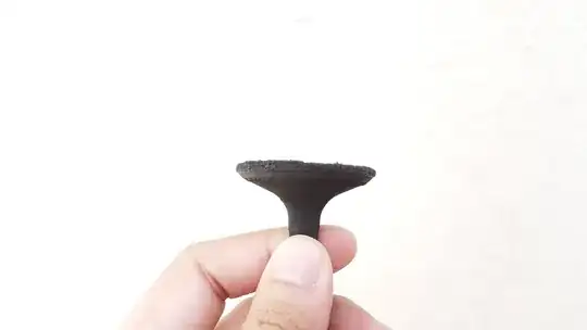

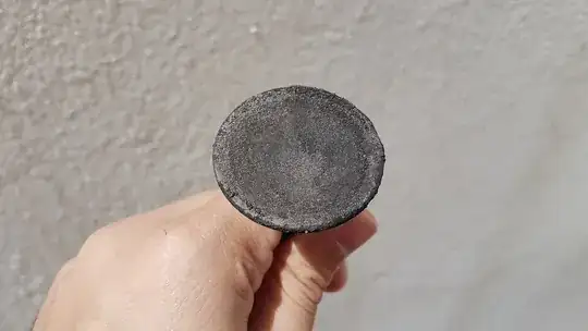

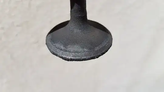

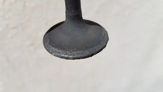

This valve is from my LS1 (Exhaust #3). It's suffered from a lot of carbon build-up due to a history of fueling/spark problems.
I've tried cooking it in ethylene glycol. I've tried using abrasion with a drill-mounted brass wheel brush, and it hasn't improved the situation much.
Can I just start lapping this valve by hand or would that damage the valve seat?

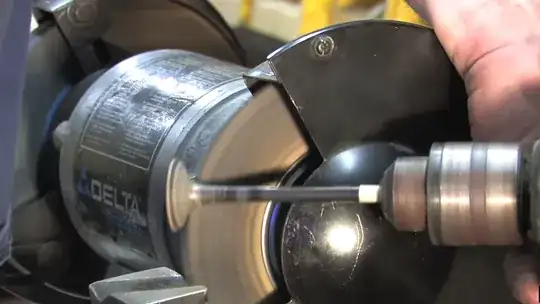

I'd highly suggest you do what Jafromobile showed to do in this video. For the uninitiated, he suggests you get a brass wire wheel on a grinder, then put masking tape on the stem of the valve, secure the valve stem in a drill, then using both the rotation of the drill and the wire wheel, clean the heck out of them. The dual action of both the valve spinning and the brass wire wheel should do the trick, as well as prevent a single area from getting hammered too much. Here's a still as he works from the side to clean the backside of the valve.
