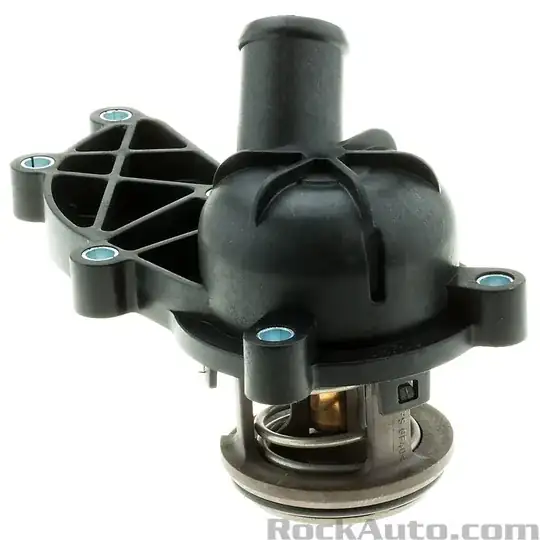

From researching on this car, it seems like the thermostat is a common issue. However, it was replaced by the previous owner ~2 years ago (some people have replaced it twice). If a thermostat only partially opens, will this cause excess heat? I don't get any fault codes.

What's a good next step? I'm thinking try replace the thermostat (not an easy job, it's part of the water pump assembly). As these components are all quite expensive, I'm not sure what further diagnosis I could do...

I'm thinking you may have either a clogged radiator or a bad thermostat. If the thermostat is going bad (sticking closed), you'd most likely see the top radiator hose being a lot cooler than the inlet side heater hose. If the radiator is clogged, the lower radiator hose will probably be cool (or most likely look warm) to the touch (though don't just go grabbing it without knowing the temperature of it ... may be a little uncomfortable).
More than likely it's the thermostat, at least this is where I'd lean.
The thermostat itself is not part of the water pump.
Also, remember, your A5 has two coolant pumps ... one mechanical (main) and one electric (auxiliary). The auxiliary one is used for after the car is turned off (I'm assuming it runs when the fans run to circulate the coolant when the engine has stopped running). If the thermostat isn't allowing coolant to circulate properly, I'd suspect it would give you your symptoms.
