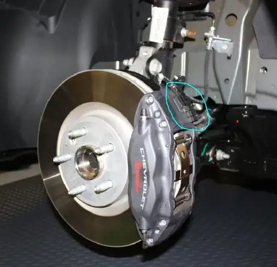

I think you already figured it out. Since it doesn't touch anything and the E-brake doesn't hook up to it, It is almost certainly a counterweight or dampner of some kind. If the caliper doesn't weigh enough (or weighs too much), it can cuz squealing and juttering under load. I can't find a link that corroborates this information, so-
As an example, the calipers on the early model Gen 5 Camaro didn't weigh enough, so the factory solution was to "stick some wheel weights on it" until edit: they added dampners to the back of the padsenter image description here
