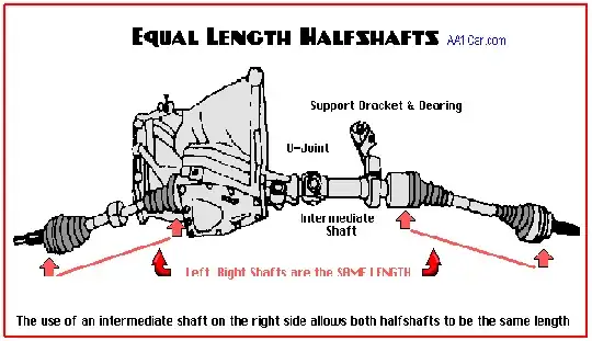

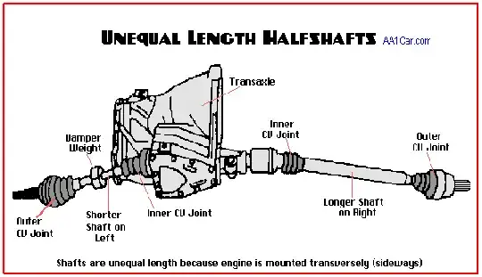

Torque steer is where a front wheel drive car pulls to the left or right under hard acceleration. This is relatively common in older front wheel drive cars, but as it is negligible in low powered cars it was not an issue. The problem comes when you have a high powered engine and all of a sudden torque steer can be rather spectacular.
It is caused by one half shaft being shorter, and at a different angle to the other, on a transverse-engined car. The fix is to ensure the half shafts are identical. See these two pictures from aa1car.com.
