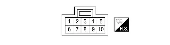

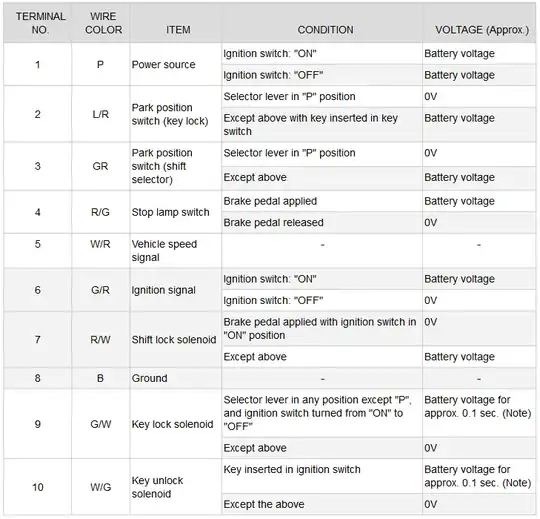

I think your best bet would be to isolate the shift interlock control module from the brake switch using a relay.
Looking at a pin voltage chart you can see that the park position switch in gear supplies B+ to the module, the brake switch (applied) provides B+ to the module and the control unit grounds the shift lock solenoid.
I'd probably use a 5 pin relay and cut into brake switch circuit at the module.
85 - Tap into the park position switch wire.
86 - Ground to the chassis.
30 - Brake switch circuit.
87 - Blank.
87a - To Pin 4 at the module.
When the lever is in the park position the relay passes B+ to the module allowing the interlock solenoid to operate. When the lever is in any other position the module never sees a brake switch signal and no more solenoid noise when driving. There's probably an easier way to do it.
