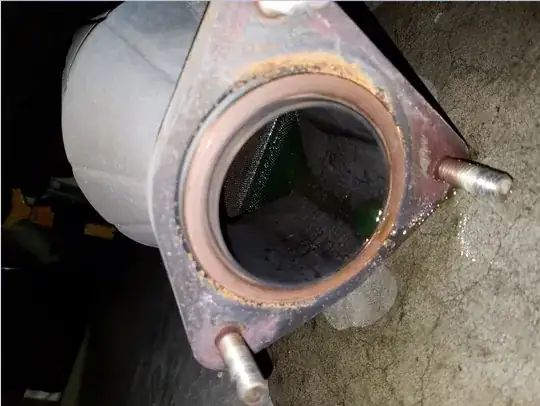

The catalytic converter on a 2007 Mazda RX-8 is full of engine coolant. Is there any way this can be saved or do I need a new cat? It seems to me that coolant won't melt the cat like unspent fuel or oil would, And water molecules pass through here all the time. The big worry for me is the anti corrosion stuff in the anti freeze, and how it reacts with platinum/paladium/ceramic,etc.
I was thinking maybe wash it out (pressure washer? Distilled water? soap? hold it out the window going 150? joking) and let it dry. I'd like to re-use this thing if at all possible; cats are expensive.
EDIT: I just ran the garden hose through it for a few minutes, both directions and let it sit in the sun for a week. It passed emissions (just an OBD check, they didn't use the little sniffer wand) and hasn't thrown any codes or acted weird. Haven't noticed any exhaust leaks. 02 sensors have looked normal ever since it finished burning all the vaseline.

The concern is valid. Liquid coolant is not of particular concern when at ambient temperature. At higher temps the Phosphorous, used as a corrosion prevent agent in coolant, is a concern. It binds with the Cerium used as an Oxygen storage agent in the catalyst substrate to form CROP, Cerium Oxide Phosphorous. This makes the Cerium unavailable to passing Oxygen. This then reduces the amount of available Oxygen to react with fuel molecules. Phosphorous does not bind with the more noble metals, Platinum, Rhodium and Palladium. Note that the above is a much simplified version of the catalyst contamination processes.
It is acceptable to rinse out the catalyst with water. Reactions to not take place below 350 degrees F. It is acceptable to use a mild detergent although it is unlikely to help much unless oil based products are present. Coolant is water soluble and should rinse away with little effort. Rinsing may also remove some of the other contaminates commonly found to be clogging the pores of the substrate which can improve catalyst efficiency. Ash is usually found in catalysts and mild agitation will dislodge some of it. This is good thing.
After cleaning dry completely before installation to avoid unlikely, but possible, thermal cracking. Install with new gaskets, confirm no exhaust leaks. Run as normal, see if the on-board tests pass or fail the converter. It is my usual practice to not give up on a converter until the on-board test sets a failure trouble code.
I have cleaned failed converters with a low pressure pressure washer in an attempt to revive them. This has resulted in a few that worked for a few more months. I do not recommend this cleaning method unless one is already committed to replacement if needed.
