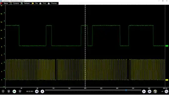

Onto the PCM which luckily is right on the upper radiator support. Backprobed the bank 1 intake camshaft position sensor and the crankshaft position sensor signal wires at the PCM.
I realize I should of included bank 2 in the capture, as well as one of the exhaust CMP sensors. When I go back I'll do another capture. I was unable to find a CMP/CKP correlation or I didn't google hard enough. The signal looks consistent and doesn't drop out. I don't believe the car has a timing issue, I find it hard to believe someone could do the same job twice and screw it up both times. But, without removing the front covers or having a known good correlation it's hard to say for certain.

Is the above capture a good bank 1 CMP/CKP correlation? What are some other possibilities for the no start?

unplug cam position sensor #1 intake side.... found tsb # PI0090E mine would buck and go dead upon restart sounds like the timing off. unpluged it started fine. drove car ran normal while engine was running pluged it back in ran until i wiggled connector engine died.. replaced sensor and pig tail...
