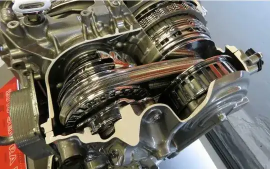

There could be. The CVT transmission is a common issue with most Nissan vehicles as the chain in the transmission becomes weak and goes out. I've had it happen before. What I noticed the transmission do was make a wining noise and a hesitation on shifting and acceleration. Before I took my transmission in I noticed fairly higher RPMs before shifts, around 4000-5000. Based on your year model and my understanding the transmissions are warranted from Nissan for 10 years or 100,000 miles.
If there is a diagnosed transmission issue, at the time of writing this, Nissan just ships a new transmission and they swap it out but my understanding later in 2017 the dealer will be allowed to break into the transmission for repairs.
I would monitor your transmission for awhile and if you start experiencing shifting issues take it in. You could even now take it in and just have your "friend" pay the service fee. Either way this is why I don't let others drive my vehicles.
Picture of the CVT chain:
Reference pic from: "Should you buy a car with CVT transmission?"
