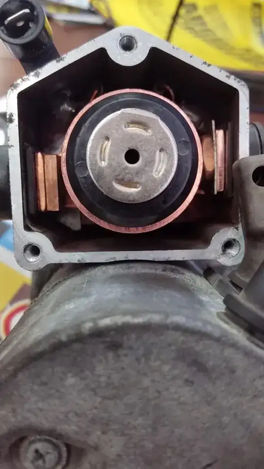

The contacts \ plunger were replaced and the starter was installed: started on first try.

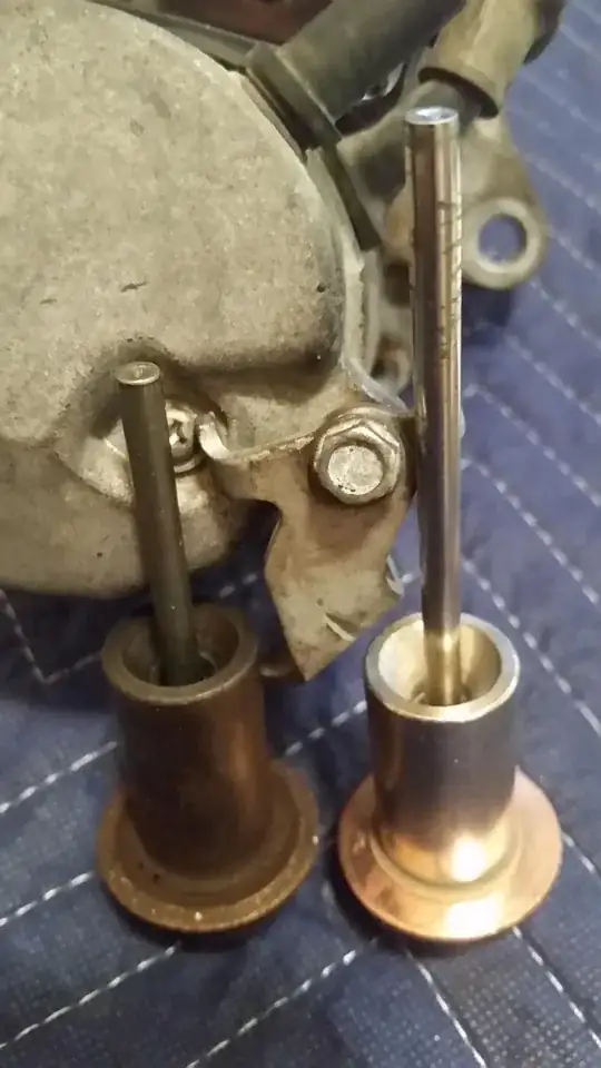

The new plunger had to be cut to match the old plunger. Note the pitting in the old plunger (22 years of service):
New plunger rod had to be cut to size:

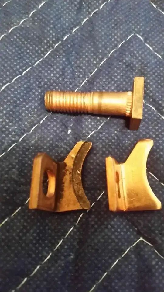

New contact (right) is smooth and old contact (left) is pitted: enter image description here
New plunger and new contacts: enter image description here
