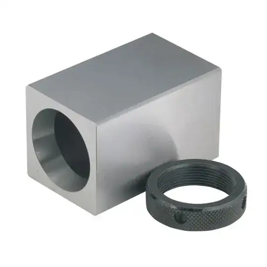

Use a collet block
Collet Block
These are designed to take a collet and tighten down on a rod. It works just like collets in a lathe or the spindle on a mill. You can hold the block in a vise, install the appropriate collet, tighten it down, then get to work without damaging the stock material.
EDIT: Alternatively, use V blocks. These are less preferred because they can still damage your rod, and they only provide four point contacts instead of continuous circumferential contact, but they're also less expensive.
