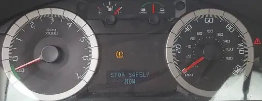

We own a 2008 Hybrid and around 70K miles we started having serious unknown problems. Unknown because even the dealer could not figure it out. You would be driving down the highway and the car out of nowhere would shut down and display the message Stop Safely Now. We would pull over the side of the highway as fast as possible, put the car in park and just wait around 10 minutes and start it back up again. This was the "trick" we had to resolve to since the dealership could not find the root cause and every time it was brought into them for service the issue could not be replicated.
Stop Safely Now

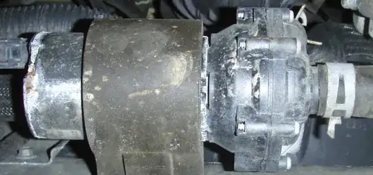

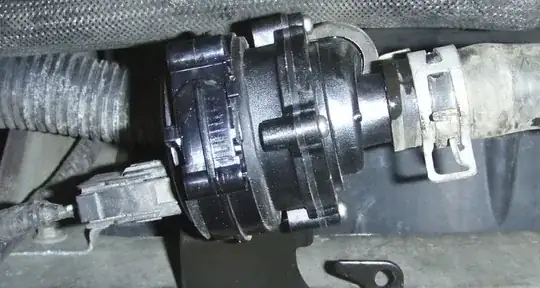

The first attempt at fixing the sudden shutdown issue was to replace the Electric Motor Cooling Pump. Since it was a recall the dealer replaced it for free.
Original Pump
The picture pump above is the "out the factory model". The one below is the replacement model. There is an obvious size difference between both.
The replacement version is smaller
You can find instructions on how to replace this pump yourself on many websites/blogs such as blog.yagelski.com. We had to replace this pump twice after the dealer replaced it. I purchased both from Amazon, search for 2008 Ford Hybrid DriveTrain MECS Coolant Water Pump. The best do it yourself instructions can be found in this video provided by FordTechMakuloco.

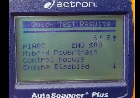

After a year of being parked the choice to junk the car for cash was made but not before I felt confident all possible repair attempts were exhausted. I went to the nearest Advance Auto Parts and borrowed their OBD Reader Scanner Tool. I had 6 error codes to research and find solutions to. My research included reading forums and watching YouTube videos especially the FordTechMakuloco channel. I'll spare you the fix details to the first 5 errors. An alternate fix to the last error on the list P1A0C proved to be the most frustrating/elusive. Every solution I found for that error was to replace the MECS Coolant Water Pump; I had done so 3 times already.
The P1A0C Error Code

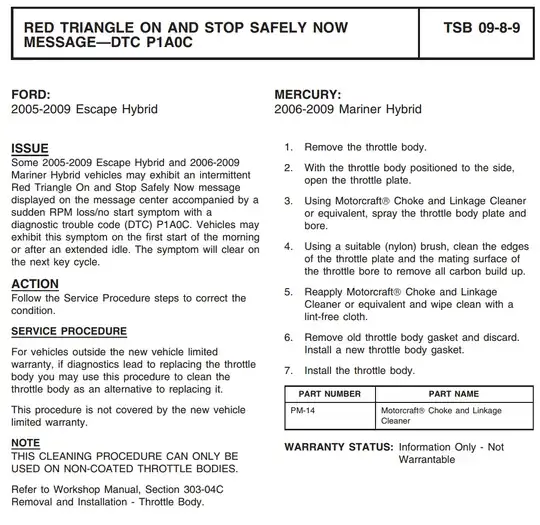

While reading forums I came across page 28 of this post mentioning a TSB (Technical Service Bulletin) that I had not seen regarding 2008 Ford Escapes. I googled the title RED TRIANGLE ON AND STOP SAFELY NOW MESSAGE - DTC P1A0C and downloaded the PDF.
P1A0C TSB
The Service Procedure states that
For Vehicles outside the new vehicle limited warranty, if diagnostics lead to replacing the throttle body you may use this procedure to clean the throttle body as an alternative to replacing it.
Cleaning the Throttle Body I had not tried. As mentioned I watched hundreds of YouTube videos, two of them from FordTechMakuloco came to mind. The first and the second which related to the 2008 Ford Escape prove to be worth gold.

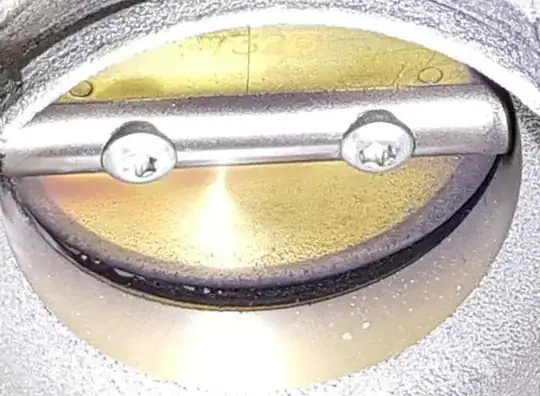

I followed the video(s) instructions. Right before taking out the Throttle Body I noticed the ring of sludge mentioned in the videos (pictured below). Quickly headed over to Advance Auto Parts and got me a can of CRC throttle body cleaner
Throttle Body Dirty

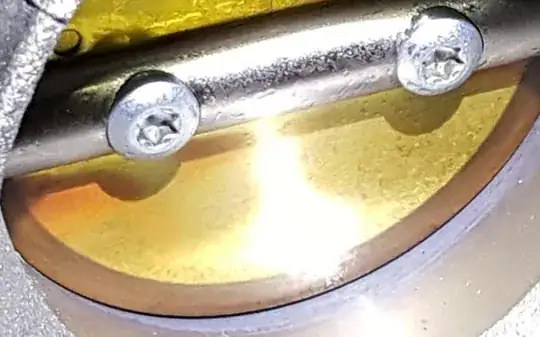

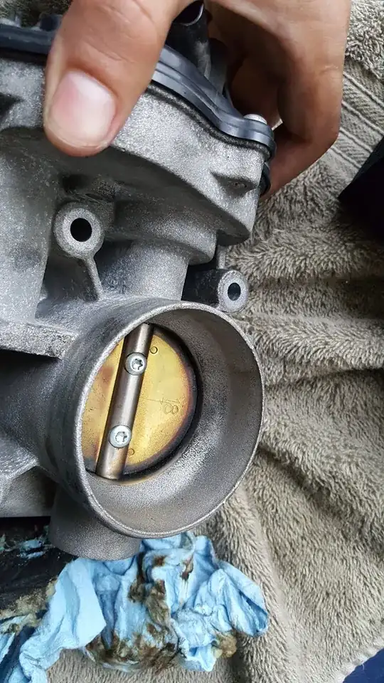

I cleaned the inside of that throttle body until the liquid ran out; way too much if you ask me. But I was not going to leave anything to chance.
Clean Throttle Body
I have waited 5 months prior to creating this post. Since the Throttle Body cleaning procedure, I have not had a single Stop Safely Now event; Nor have I had to replace the MECS Electric Motor Cooling Pump. I been driving the car daily and can confirm the issue has been resolved.
